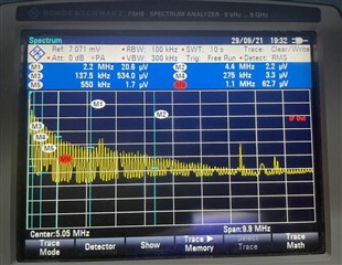

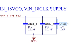

My customer made 4-chip AWR2243P cascaded board by own design and uses LP87624B as the PMIC to AWR2243. But customer found the 1.0V on their own board is not good as TI cascaded RF EVM.
1.0V from customer's board
1.0V from MMWCAS-RF-EVM
The PMIC related schematic design of customer's board is similar as TI EVM, but customer puts the LC filter close to AWR2243 instead of PMIC output (how TI EVM designed). Is this cause the issue? If not, do you have any comment to improve the 1.0V quality of customer's board?
