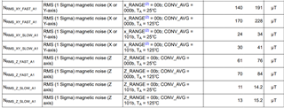

    TMAG5170 is capable of performing measurements of the magnetic field for changing magnetic fields.  One of the primary functions is to use a rotating magnet which will produce sine/cosine inputs that it can use for angle calculations.  It will sense the composite field for any conversion cycle.
    When performing these measurements, the device does so serially (X-Y-Z-X-Y-Z), and requires 45 us for the first conversion and each subsequent conversion in the pipeline would require 25 us.  So in continuous mode, a minimum sample time for all three axes is 75 us.  As a result, we could achieve the minimum sample time for signals up to about 6 kHz.  However, it is important to remember the input referred noise relative to the expected input field.  If too high, then oversampling would be required which allows the device to average.  Supposing 16x averaging were enabled, then the new sample time would be approximately 1.2 ms and the device should be just above the minimum sample rate for an 400 Hz signal.
    If only one or two components are needed, then the averaging could be increased up to 32x.
    As a reference please note the noise specification here:
    Scott
