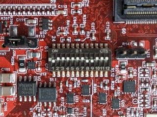

I can't connect MMWAVEICBOOST to my computer to flash my IWR6843ISK. I followed the setup described in the tutorial: https://training.ti.com/hardware-setup-mmwaveicboost-and-antenna-module
When I try to flash my radar via UniFlash, I get the message "Image loading failed: Not able to connect to serial port. Recheck COM port selected and/or permissions." (screen)
My SOP2 is ON (screen). I have checked my COM port (screen) in Device Manager. I have done nRESET before flashing. I checked all my switches and jumpers. I have tried different USB cables and different power supplies. I have tried several different computers. I also tried different IWR6843ISK modules. Nothing worked. What else can this be? Do I have a defective MMWAVEICBOOST?
