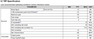

According to the data sheet, TYP output power of IWR 6843 is 12 dBm.
We have tested xWR6843ISK EVM in our chamber,
and it seems that  the output power is about 14 to 15 dBm.
We understand that there is some variation among the lots, but is it a normal result?
The data sheet dose not specify the MAX power as the figure bellow,
so we would appreciate it if you would let us know the actual MAX out power of IWR 6843.
(We set the output frequency to 60.0 to 60.5GHz.)

    If you can run a one-time run-time calibration (CLPC mode for TX power calibration) after profile configuration. This will ensure the calibration is tuned to the center of the band being used.   With that, there will be a +/-2.2dB variation around the typical spec.
    The calibration can be manually triggered easily through radar studio, but it will need a DCA1000 board.   Do you have one?

    The SDK out of box demo has the right calibration procedure.  For easy operation, you can just test the TX power with SDK out of box demo binary,  The TX power variation should be within 2.2dB from the datasheet.
