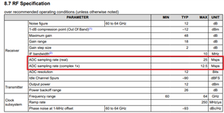

  • Ah, I am working against SDK 3.4.0.3 and this information was not present. I have downloaded the most recent SDK and confirmed that the information is there.
    This raises a few new questions:
    1. Where does this minimum limitation arise from? The high pass filters in the IF signal chain are much lower in frequency than 2[MHz], so it should be reasonable to limit the DFE sample rate to a lower frequency.
    2. The data sheet is very misleading (see below) since it indicates no lower bound for the ADC, will this be updated?
    -- Curtis
  • HI, Curtis:
    The minimum ADC rate is limited by how many down-sample stages are there in the RX chain.  I will let the design team know your feedback on datasheet.
    Zigang
