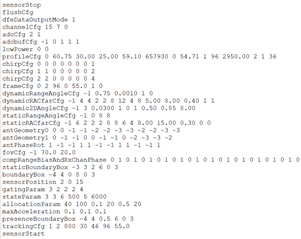

I finished up the ROS modification for 3D people counting demo. When I launched my sensor it launched without any error. But, I can't see any published output ( Point cloud ) on the Rviz window on my linux machine.
I used the following cfg file to run a 3D people counting demo.
Please any suggestions or advice to fix the output issue ( not publishing the point could ) to look at it?
