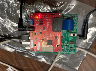

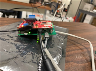

  • I am using an older version of mmWave Studio (1.0.0.0) because it seems like the newest version does not work with AWR1443BOOST ES.2. And I have gotten it to work with this version in the past.
    Here is an image of the connections.
  • Hello Hailan,
    Sorry for the delay due to holidays.
    Were you able to get your setup working? Or are you still facing issues?
    In case your FTDI drivers are expired, you can update them using the latest studio version and then switch back to an older version for your device.
    Ishita
