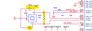

    3)  Crystal capacitors and resistors:
    For the crystal 4.7pf capacitors are recommended,  schematic shows 10pf which is much larger than recommended.
    R23 resistor need to be removed, this disturbs the biasing & loads of the oscillators.

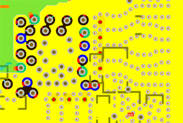

    Bigger problem is seen with the layout:
    1) Layout requires mico vias for the RF traces (These are GCPW 50 ohm traces) which is missing in the layout.
    Micro vias are needed around the RF balls and via fencing for the RF trace, Without this transmission line will not be matched to RF Ball or Antenna ports. This is the most important issue in the design which is causing poor output power and link-budget.
    Please refer to IWR1443BOOST EVM reference design
    also for the Rx2 shown below on the top layer ground clearance is not proper these kind of structure causes impedance mismatch.
    Just under the RF balls there are ground opening are provided as impedance matching structures, They are missing in the current layout.

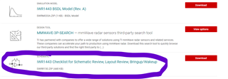

    Please refer to schematic and layout checklist for the board development before sending it to fabrication.
    https://www.ti.com/lit/zip/swrr150
    We checked the IWR1443Boost board, there are no mico vias on board in spite of he mico vias marked on sprr253-IWR1443BOOST Layout and Design Files.
    2)Just under the RF balls there are ground opening are provided as impedance matching structures, They are missing in the current layout.
    We don't understand about it. We have the ground layout. Please check again.
  • Hello user1213293 ,
         Please see below screenshot of the reference design which shows the micro vias in the design. Micro via must be needed to ensure 50Ohm GCPW transmission line.

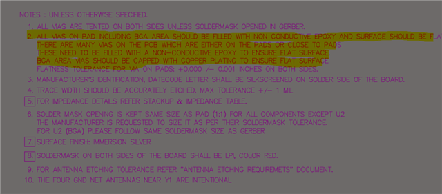

    Please review the FAB notes, vias are filled and capped with copper plating to ensure flat surface. If you see through the top surface you will not notice presence of Via. You need to do cross section examination to identify the Micro vias.
    2) Layer 2 ground opening under the RF balls:
    Please note in the below reference layout of the EVM, there is ground opening provided for the RF signal as impedance matching structures in the Layer2.
    This is mentioned in the above "layout checklist" under Layout guidelines in the checklist.
