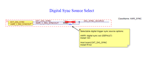

              As mentioned on the link too there are 2 ways to feed the hardware trigger on the MMWAVE CAS RF EVM. One if from the Primary radar device which is AWR1. The primary device feeds to buffer which then feeds to all radar devices including primary device itself. this is the default configuration on board.
    The other option which is EXT_DIG_SYNC connected to HOST(for example this signal is coming to the TDA2 MMWAVE_CAS DSP EVM mating connector).
    If you intend to feed it from some external other then the arrangement made, you can explore on TP1_1.
    Once you feed it externally you will have to also ensure that Primary device trigger is also moved to hardware(from default software).

    Once you make the modification sin hardware for hardware trigger then the script should also be updated accordingly to configure the trigger mode in device.
    DIG SYNC is used for Frame trigger.
    The TP1_1 is connected to AWR_1_DIG_SYNCOUT.
    As a suggestion you can TRY to connect on this TP and mount the resistance as shown below(remember to open R143), other wise you can solder the resistance on R142 one pad itself.
