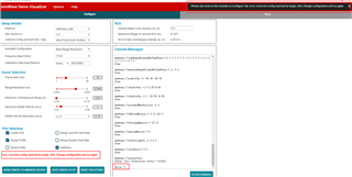

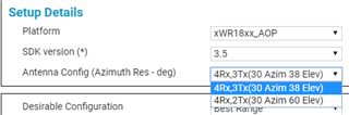

We can config 1RX 1TX  for xWR18xx in mmWave Demo Visualizer 3.5.
However, we don't see the same option for xWR1843AOP.
Our question is does the 1RX 1TX work for xWR1843AOP in out-of-box-demo?

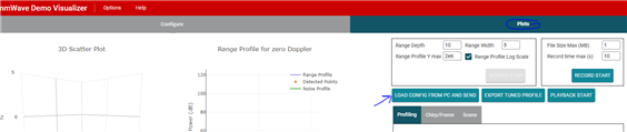

Actually, We want to bypass CLI, enable 1RX 1TX for xWR1843AOP in out-of-box-demo.
