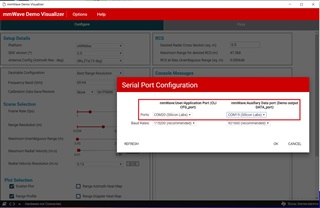

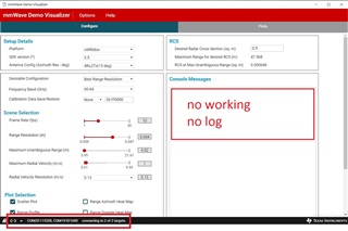

    We capture mmWave Demo Visualizer usage
    Pic1 and Pic2 are not working PCBA ,
    Pic1 : Serial Port Configuration is normal .
    Pic2 : In pic2 setup and connecting are normal , but no working no log
    In pic3 and pic4 are normal PCBA , working normal and have log .

  • Hi Andy,
    It seems there is an issue with the data UART port connection. Before we dive into HW debug of the port, can you use CCS to connect, load, and run the program from the link above? This will tell us if there are any software errors.
    Also, if you connect to the CFG port (COM20) with teraterm or putty or some serial terminal, you should be able to see the CLI printout mmwaveDemo>> on the screen and it will echo what you type. This would confirm if the device is running and started normally in addition to the CCS debug.
