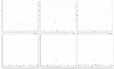

I am using the AWR1843BOOST board to evaluate its performance as an on-board drone (quadcopter) radar solution. For the test purposes the board is attached to the drone frame facing forward in the flight direction (slightly inclined by 10° upwards). The drone then multiple times was guided to intercept a static hovering DJI Phantom 4 drone. The DJI drone was detected by radar, but after plotting the logged data, it was often observed that the detected drone in some frames "splits" in two separately detected objects, while the real target should be a point in the middle between those 2 detections, please refer to plots below:
Up to frame 3314 the drone is detected correctly, but then it splits in separate points and in frame 3315 two clusters of 2 points each are detected, while actually the drone should be in the middle. There have been similar issues also at up to 10 meter ranges. Here is also a log with with detected object coordinates + velocity:

    So the two detections happen sometimes for 3-5 frames, then they can merge back to one point. For the majority of time the drone is detected correctly and those two detections happen mostly when the drone flies perpendicularly towards or away from the radar.

    Here is one of the frame with detected object info on the left. Points 3 and 5 make no sense based on their z values, which are below ground level. Could you confirm whether the issue still lies within the firmware or if those are indeed multipath reflections (3 and 5 could be due to reflection from ground, but I see no reflection path for 6 and 4, those points also are not quite showing the drone location correctly).
    Some more pictures below for setup reference, also you can see that mmWave Visualiser shows similar issues.

    I am able to see the youtube video. The behavior is definitely not correct.
    We will need more data points to understand the behavior. The best would be if you can capture raw data.
