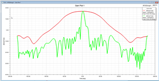

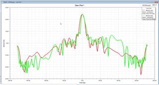

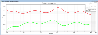

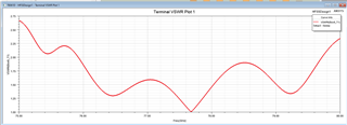

    Thank you so much for the valuable inputs, much appreciated.  We will recheck our PCB design w.r.t. the points you have brought into attention. Regarding to the "beam tilt across operating frequency band" you pointed out, I am a little confused.  Attached are the characteristic curves of our Tx antenna design at this stage. We will employ it as 1 Tx and 4 Rx topology. The optimum frequencies of Tx and Rx arrays are matched at around 77.7GHz.  Rx arrays have gain around 17dB whereas Tx array appears to be around 24dB.  No beamforming needed. Long range stationary radar, we are interested in a beam width of only +/- 10 degrees.  Attached are the characteristic plots of the Tx array.  My inquiry: As seen in the Frequency as well as VSWR plots, the "optimum" frequency band is very narrow (i.e. gain drops considerably when the frequency moves off of 77.7GHz.)  Any possibility for beam tilting under these conditions and if there is what can we do to eliminate beam tilting?

  • Hello Hasan,
         Thank you for sharing the simulation results.
         Typically high gain antennas are used in longer distance and would be used for narrower frequency bandwidths, This is traded-off with the range resolution to meet the max distance, IF bandwidth, memory, MIPs etc computational goals. One would be using narrow RF frequency bandwidth typically 500MHz to 1GHz for longer distance. Hence, it should not be a big problem in your application.  Beam tilt is a typical problem in the series fed patch array PCB based Antenna designs for high gain antenna. You may want to re-run your link budget analysis by keeping desired frequency of operation, if the roll of of beam due to tilt is not acceptable, then you may want to reduce the gain and increase the beam with at the cost of reduced Tx/Rx gain.
    Another option is to consider beam steering capability offered by the Tx phase shifters. Device offers 6 Deg beam steering capability. This also warrants simulations to confirm grating and sidelobes are suppressed sufficiently.
    Series fed patch antenna for higher gains also increases higher losses and over all decreased efficiency of the antenna. You may have to pay attention to this point as well, Lower substrate loss (like R03003 is one of lowest loss material even compared to Ro3003G2) will help in lowering the overall antenna loss. There are other consequences like peel strength, manufacturing constraints, bonding with other layers of substrate materials, drill, high temperature requirements etc also have to be carefully need to be weighted for the application requirements.

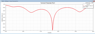

    In your design, you have good match between 76 to 79GHz. That is good. And your best matching frequency is 77.7GHz, Due to limited etching tolerance from the PCB manufacture this frequency move up or down depending upon under etching or over etching of the traces and Antenna geometry. You may want to run simulation depending upon the min-max over etching and under etching tolerance limits of PCB manufacturer. If the frequency deviation is under your design limits then you are ok. Typically design is done such that Antenna/Transmission lines meets the design goals of PCB tolerance limits.
    It may be wise to run the test after the fabrication to find out what would be optimum frequency at which best matching is obtained and design your chirps at those frequencies.

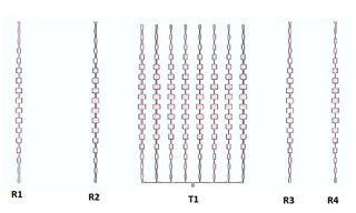

    Once again our gratitude for the insightful inputs; they were some genuine assistance for our design job. I would like to  hear your further comments based on our not-so-conventional topology.
    Being aware of resolution loss at high-gain long-range designs, we opted for a typical sparse array topology employing four independent 16-element Rx arrays and a single 8 x 16 element Tx array, all series fed. Our estimations  playing with inter-array distances indicated that a resolution about 1 degree or less (hopefully) would be possible. This has to be checked in the lab first then in the field (after integration to the 1843Boost circuit.)  Here is the topology we work on:
    (It might not look convenient for the feedlines on a single pcb plane while employing 1843 however we devised a way to  "feed" the T1 properly.)
    We still are in the designing phase, so your suggestions/inputs would help us a lot in proceeding on the right path toward the goal.

  • Hasan,
        Thank you for sharing the antenna structure. This structure is not uncommon and published in literature in many places. Below are some example  published in IEEE.
    IEEE Xplore Full-Text PDF:
    Conventional lamda/2 spaced virtual array would limit going into higher angular resolution, one has to explore other higher angular topology such as sparse array /MUSIC algorithms with some trade-offs. In sparse array topology one need to explore grating lobes/spectral leakage emanating due to gaps in the virtual array as compared to linear arrays. This would be limiting the dynamic range of angle estimation. Are you planning to use other Tx2 and Tx3 also to maximize the number of virtual antenna pairs?
    For further improving angular resolution, one could explore multichip cascaded solution in AWR2243 kind of product, But it would be more complex than single chip solution.
    Yes, It's not clear from the picture for the feedlines, But care must be taken to minimize the transition losses and well matched to antenna ports.

    Just a final inquiry: Please note the gain curve below: Is this the "Beam Tilting" you warned about?
    Thank you.
  • Hello Hasan,
         This appears to be simulation done for the Rx antenna at 77GHz for Azimuth and Elevation cuts. You may wan to look at all the Antenna pairs.
    If you are operating chirps from 77-78GHz or 77 -79GHz then you may want to review the whole frequency band for the antenna radiation pattern at say 500Mhz interval, and review antenna gain at the desired field of view and review does it meets the link budget requirement or not.
