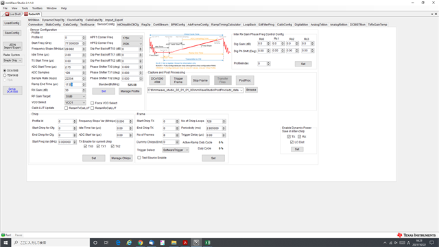

What is the red frame part of the image?
And why does this happen?
teach me please
teach me please

Can you send out your profile configuration? I am not sure it is normal.

What is your device name and ADC mode? 22MHz ADC sampling rate looks too high to me.

The chirp design looks fine, I checked on the rampTimingCalculator tab inside the radar studio. I do not have an answer to your question. What is your test scenario?
Can you play with the slope (double or half) and see how this hump changes?
