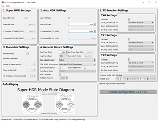

  • Hi Alex,
    I use the configurator tool to generate the configuration file. The screenshot is attached below:
    Thanks!
    Olga

  • Hi Olga,
    I do not see any issues in your configuration here so not sure why you are seeing these longer times. Using the EVM and the EVM GUI are you able to replicate this issue?
