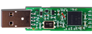

i buy two LDC1000EVM from TI. One Board run. The second board is faulty. Testet Both on Same PC with Win-7 System.
on the faulty Board it come Sound when i Connect to PC. The red and Green LED Blink, Then Both LED Turn off. How
to do?

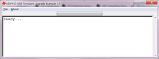

Can you try to perform a firmware update on the faulty board by going through the Sensing Solutions EVM GUI? Additional instructions on updating the firmware are in the EVM user's guide section 1.2.9.
Also, how does the EVM show in the PC's device manager?

You could try re-flashing the EVM by putting it into BSL mode and flashing it through the Python firmware upgrader. Here are some more detailed instructions for that:
If this is not the case, ensure that the device is in BSL mode (no LEDs will be on) and click File -> Rescan HID Bus
At this point, the EVM should be recognized by the Sensing Solutions GUI and connect properly. Between reflashing the EVM and manually updating the USB driver, the issue should be resolved. If you still have issues, it is possible that the board is damaged.
