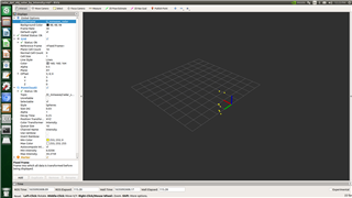

After I finished modifying ROS to make it work for 3D people counting. When I launch the sensor for 3D people counting demo, and plot it on the Rviz window, the points cloud is scattered.

Please I need guidance and suggestions on how to make my points cloud look better ( not scattered) in order to detect humans.
