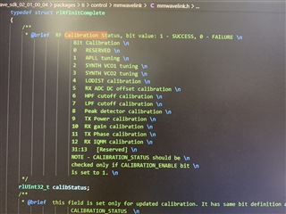

    From this error code, 0x3fe, I've determined that the code points to the asynchronous phase lock loop calibration failing, as shown by the following image:
    The power supply is fine. I'm using the same exact power supply and binary mss file (for flashing) on a second AWR1443BOOST + DCA1000EVM board, and it's running the demo visualizer without any error.

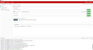

    Proof of successful flashing:

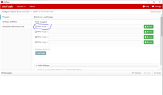

  • Hello, which version of Uniflash are you using? Can you try version 6.3 and then load the image into the metaImage1 slot?
    I am assuming you are not using a custom config and are seeing the issue even with the default config sent by the visualizer?
    For our records, can you please provide the voltage/current rating of the supply you are using?
    Adrian
    I’m currently using Uniflash version 6.4.0. I’ve tried your suggestion with Uniflash v6.3 and I’m still getting the same error.
    Again, my power supply is fine. I’ve been using my second newer AWR1443 BOOST for longer than I’ve used this older broken AWR1443 BOOST unit on the same power supply (max rated 5V 5A), and I have no issues with the newer unit.
