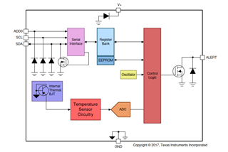

I am looking for some missing information in the datasheet of TMP117.
In the block diagram there is an internal oscillator. Do we know what is the output frequency of this oscillator ?

Hi Lalit,
The oscillator is used internally and not available externally in any capacity. That's why it is not specified. Why are you interested in this oscillator's frequency?

Hi Lalit,
ADD0 tied to SDA is a valid configuration of the address pin. It would be necessary to tie ADD0 to either SCL or SDA to have 3 TMP117 devices on the same bus. ADD0 is an input-only and could not contribute to activity on SDA.
This oscillator runs at over 100kHz. It must cycle the logic through many states during an ADC conversion. The ADC conversions take 15.5ms when averaging is disabled. This puts the max conversion rate at 64Hz; far outside the range you're investigating.
TMP117 is an I2C slave/target. It is not capable of initiating transactions on the I2C bus. It cannot control the state of the SCL pin, and it should not take action on the SDA pin unless called upon to do so during an I2C transaction. If you find that your TMP117 takes action on the SDA line when it should not, we would consider this a faulty device and request to investigate it as a return.
Could you zoom in the timescale to see if there is an I2C transaction happening at 400kHz or (possibly) above? This is a common frequency for I2C, and the entire transaction could occur in 45us, or half your current time scale.
