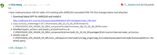

Hi team,
Following the steps in Processor SDK – Radar User Guide 3.2, then will always result in the following error,  in the meantime, referring this post to update the firmware and code, this post's Compilation methods and issues.
Is the path inside the command line correct? The build path inside the user guide is viv_sdk directory, and the E2E case is built under build path, and both are not totally correct. And is the xdc tool path setup correct?
The build error is similar to this posthttps://e2echina.ti.com/support/sensors/f/sensors-forum/205001/mmwcas-rf-evm/643046?tisearch=e2e-sitesearch&keymatch=SDK%2525252520build#643046

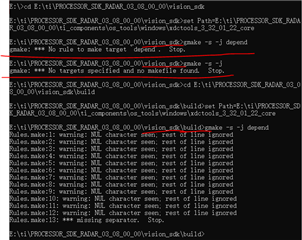

C:\Users\admin>cd C:\PROCESSOR_SDK_RADAR_03_08_00_00\vision_sdk\build
C:\PROCESSOR_SDK_RADAR_03_08_00_00\vision_sdk\build>set PATH=C:\PROCESSOR_SDK_RADAR_03_08_00_00\ti_components\os_tools\windows\xdctools_3_32_01_22_core
C:\PROCESSOR_SDK_RADAR_03_08_00_00\vision_sdk\build>gmake -s -j depend

"src/edma3_drv_init.c", line 1: error: null (zero) character in input line ignored
"src/edma3_drv_adv.c", line 1: error: null (zero) character in input line ignored
"src/edma3_drv_basic.c", line 1: error: null (zero) character in input line ignored
Error limit reached.
100 errors detected in the compilation of "src/edma3_drv_init.c".
Compilation terminated.
100 errors detected in the compilation of "src/edma3_drv_basic.c".
100 errors detected in the compilation of "src/edma3_drv_adv.c".
>> Compilation failure
>> Compilation failure
>> Compilation failure
gmake[4]: *** [C:/PROCESSOR_SDK_RADAR_03_08_00_00/vision_sdk/binaries/apps/tda2xx_cascade_bios_radar/obj/edma3lld_drv/tda2xx-evm/m4/release/edma3_drv_init.oem4] Error 1
gmake[4]: *** Waiting for unfinished jobs....
gmake[4]: *** [C:/PROCESSOR_SDK_RADAR_03_08_00_00/vision_sdk/binaries/apps/tda2xx_cascade_bios_radar/obj/edma3lld_drv/tda2xx-evm/m4/release/edma3_drv_adv.oem4] Error 1
gmake[4]: *** [C:/PROCESSOR_SDK_RADAR_03_08_00_00/vision_sdk/binaries/apps/tda2xx_cascade_bios_radar/obj/edma3lld_drv/tda2xx-evm/m4/release/edma3_drv_basic.oem4] Error 1
gmake[3]: *** [ipu1_0] Error 2
gmake[2]: *** [edma3lld] Error 2
gmake[1]: *** [edma3lld] Error 2
gmake: *** [depend] Error 2

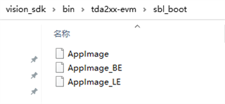

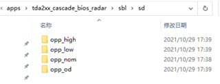

    1. Build generated SBL and appimage file type differences and matching board type:
    What are the four SBL file type differences below, and how to choose to match the different board types (Cascaded TDA2x & Monolithic TDA3x)?
    For the appimage file type, the customer has checked  the forum that AppImage_LE is a small-end file for SD and NOR boot mode; AppImage_BE is a large-end target for QSPI boot mode. Other Load methods like SD cards only, CCS, can only use the first file below to App Image file?
    After the customer has copied the MLO file in the SBL file opp_nor and the AppImage file above to the SD card, start the setup in Tera Term to the Chains Run-time Menu as follows:

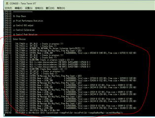

    [IPU1-0] ====================
    [IPU1-0] Chains Run-time Menu
    [IPU1-0]
    [IPU1-0] 0: Stop Chain
    [IPU1-0]
    [IPU1-0] p: Print Performance Statistics
    [IPU1-0]
    [IPU1-0] g: Control GUI output
    [IPU1-0]
    [IPU1-0] c: Control Calibration
    [IPU1-0]
    [IPU1-0] d: Control Peak Detection
    [IPU1-0]
    [IPU1-0] Enter Choice:
    [IPU1-0]
    [DSP1 ] 1449.042762 s: RADAR DSP PROCESS: Changing the GUI parameters
    [IPU1-0] 1862.335722 s: GUI Monitor (0/1) (<pointCloud> <rangeProfile> <noiseProfile> <rangeDopHeatMap> <azimuthHeatMap>):
    [IPU1-0] 1865.232111 s: 1
    [IPU1-0] 1865.934179 s:
    [IPU1-0] 1866.287836 s: 1
    [IPU1-0] 1866.637772 s:
    [IPU1-0] 1866.991368 s: 1
    [IPU1-0] 1867.342524 s:
    [IPU1-0] 1867.740010 s: 1
    [IPU1-0] 1868.700420 s:
    [IPU1-0] 1869.152565 s: 0
    [IPU1-0] 1870.220978 s:
    [IPU1-0] 1870.221191 s:
    [IPU1-0]
    [IPU1-0]
    [IPU1-0]
    [IPU1-0]
    [IPU1-0]
    [IPU1-0]
    [IPU1-0]
    [IPU1-0]
    [DSP1 ] 1870.221130 s: RADAR DSP PROCESS: Changing the GUI parameters
    Then run PROCESSOR_SDK_RADAR_03_08_00_00\vision_sdk\apps\src\rtos\radar\src\usecases\cascade_radar_object _detect\radar_cadad_demo.m Mattlab has reported an error as follows, and the IP address and physical address have also been changed. Is this an indication of where the protocol is having any problems?
    Radar_cadad_demo('192.168.1.200', '192.168.1.100', 'F8-E4-3B-01-5C-63', 'TI', 10 1); Warning: JavaFrame window properties will be removed in a future release. For more information, see UI replacement for MATLAB App at mathworks.com. > Position: Radar_cadad_demo (line 222) CleanUp called Closing the TCP Command server connection Closing the UDP connection Error using icinterface/fopen (Line 83) Unsuccessful open: Software caused connection abort: Connect Error radar_cadad_demo> openConnection (line 991) Open(tcpCmdSock); Error radar_cadad_demo (line 394) OpenConnection(tgt_ip_addr, host_ip_addr,tcp_port_num, udp_port_num);
