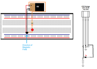

    Thanks for considering to use Texas Instruments.  What kind of particles are you detecting?  If you have a strong enough magnetic stimulus, you can try the following setup.  I think 22 AWG wire might work in a breadboard for you.  The diagram below shows the TO-92 package option.  When the magnetic stimulus is strong enough the out put pin pulls low which allows the Red LED to turn on.  I chose a 1k resistor, but you could use some other value.

    I have not heard of our devices being used for UV light or photon detection, perhaps a light sensor might be more appropriate for your application.  If you wish to proceed with our Hall-effect device, you can likely get a breadboard and wire off of amazon, digikey, mouser, or possibly alibaba.  The magnitude of your magnetic stimulus needs to be directed normal to the package as indicated in the figure below.

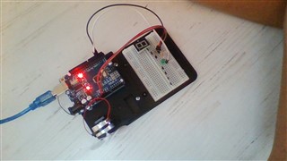

  • Hello again sir, I hope all is well. I have almost finished the setup for my detector, as shown below.
    First of all, is this setup ok (I'm still waiting on a 9V male clip and the plug to connect to the board)? I am using 10 uF and 0.1 uF capacitors, the sensor, a green LED, and connecting wires.

    Actually you do not need the 9V battery.  Your Arduino board should have a 5V pin.  As your Arduino is already powered (I presume from your laptop or computer), I would just run a wire from the arduino board 5V pin to you your sensor VCC pin and your LED anode and I think your laptop supply should be able support the current. It looks like you might already be doing that.
    As for how your Hall-effect sensors are placed, I think those are fine.  However, it is a little difficult to see where all the pins of your various components go.  I think you would probably need to reorient your 7-segment.  You might not have adequate room to fit that and everything else on your board.

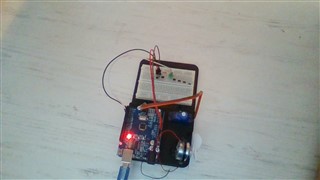

  • Ok thank you I didn't notice that. I set it up as shown in the picture, so hopefully that works. Also, I took out the segment display so I'd have more room for the sesnors, not all of which I've put in yet, since it's not a big deal since I can just see if the LED blinks. So is it okay if I put sensors going along every row in the bread board until the end +/- rows?

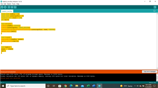

    Another issue is that when I try to run the code, I get an error message saying "serial port not selected." How can I fix this?

    For that issue, this video might help.  For further arduino issues, I would recommend going to an arduino forum if you cannot find a youtube video that covers how to fix your problem.  My knowledge on arduino is limited and I can only help you so much on that topic.

  • Ok thank you sir I'll do that. The video you sent was very helpful however it didn't work when I tried it and it said to close out of all applications and restart Windows, so I'll do that and then if that doesn't work then I'll head to an arduino forum. I also duplicated what I did on rows f-j and did it again on a-e, if you think that's a good idea. Thank you for all your help, and have a great Thanksgiving!
  • Your welcome.  You might also try using a alternate USB ports. I know I have had some ports in the past the were not reliable while others on my computer were. I think having two rows of Hall-effect sensors, one on f-j and one on a-3, is fine from an electrical connection standpoint.  Whether it is appropriately positioned for measuring your field, that I cannot say without further detail.
