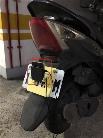

1. When the AWR1642 is installed on the car, the vibration will affect the sensing distance when the car is moving (the sensing distance is less than 40m)
2. The SRR example is relatively insensitive to the detection of motorcycles and bicycles. It can only be detected within a distance of less than 15m in a stationary state.

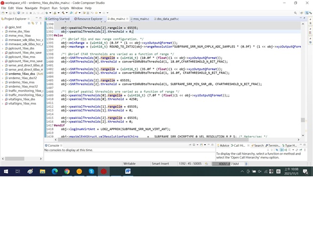

I think reducing SNR may be one of the ways, but I am not familiar with how to adjust SNR, can you give me some guidance? Or do I need to try something else?

    Can you please let us know how the AWR1642 is mounted on the car?
    What is the chirp configuration used when 40m max range is achieved?
    The SNR threshold has been adjusted for the SRR algorithm and probably should not be lowered
    thank you
    Cesar
      1. I installed it on the back of the scooter, the installation method is like the picture below
      2. The chip configuration is exactly the same as the SRR example, I did not modify it
  • Thank you for the picture.
    I think the reason for the reduced performance is the sensor enclosure.
    To confirm this could you please test the performance without enclosure?
    thank you
    Cesar
