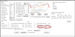

I got DCA1000 + IWR1443 to collect the data. However, when I try to change the confirg, I find many data are lost. For instance, I set the 3000ADC samples / chirp, 200 chirps/ frame and 5 frames in totally. There should be 3000000 samples. However, after I unpack the raw data, there is only 952000 samples. Further, when I collect data and click DCA1000ARM Trigger Frame, everything works well. When I collect PostProc, something goes wrong. Figures show the SensorConfig and output. So why some data is missing? Are there any config that I set them wrong?

    Where is the packet delay? Is the packet delay the same as trigger delay(fig)? What is the function of trigger delay?

    The trigger delay option in Frame config corresponds to the time delay when you press the "Start Frames" button and when the actual framing starts.

    I change the packet delay from 25us to 75us. And I change the sample/chirp from 2000 to 2100. However, it does not work. figure shows many data is lost. So I consider this problem is not caused by the packet delay. So how can I handle this?
    Furthermore, when I set 2000sample/chirp and 25us delay, it works. I check the data and find in every chirp, the 1000th to 2000th sample is 0(shown in figure). And also I change the packet delay from 25us to 75us. And the same, half of the samples is zero. What causes this? And how can I handle this?
    The config is shown in figures. Based on the graph, the
    Wu
  • Based on the config, 2100samples can be collected with in the (ramp end time - ADC start time) with 18MHz sampling rate.
