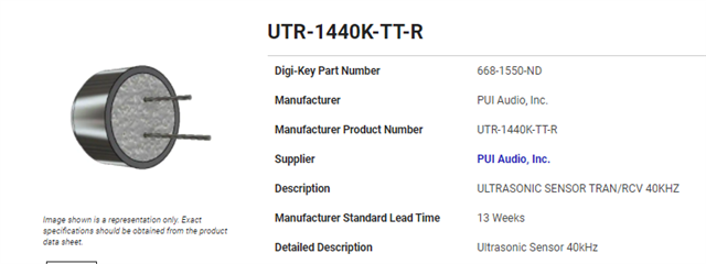

I am using a 40 khz  closed top  transducer. You can see the drive signal in blue and the Recieve signal in yellow.

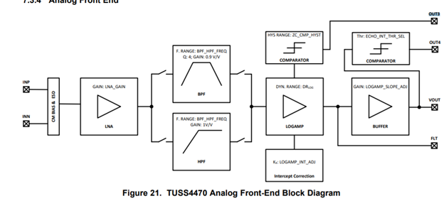

    This is the AFE for the TUSS44x0 device, Out 3 correspond to a zero crossing comparator with hysteresis.
    The purpose of this output is primarily to verify frequency of the signal and offer another direct means for generating an interrupt signal. Most applications do not require the use of OUT3.

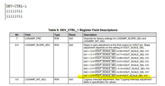

    The 2.60 V/V setting correlates with LOGAMP_SLOPE_ADJ setting 0x4

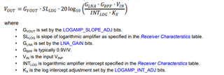

    The formula is dependent on the setting for VOUT_SCALE_SELECT, but below represents using 3.0 V/V setting with a gain map of 5V for VOUT_SCALE_SELECT.
    Gvout(V/V) = 3.0(5) + 4.56(5) = 37.8V/V
    The formula below represents the equation for calculating Vout

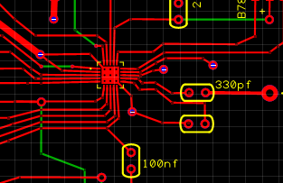

    Layout can have influence in the noise floor. Did you separate the ground pours for signal ground, and analog ground? Additionally, are these grounds properly connected to one another via a ferrite bead or a single 0-ohm connection? Section 10 of the datasheet covers the grounding technique in more detail.
    It is important to use short traces for all connections to the transducer, especially INP and INN.
    RINP can be adjusted for EMI rejection. You are welcome to try increasing the resistor.
    I do not think changing the supply voltage will change the noise floor. It is important to ensure the supply rail for the device is relatively clean, otherwise, the noise could couple into the receive signal chain. We use a low noise LDO in our EVM design, and we find the low noise performance to be critical to obtain accurate results with the TUSS44x0 devices.
    CFLT being 20nF should be alright. Sometimes the value of CFLT may require alteration from the calculated value to optimize performance.
    Are you able to revert to a previous documented version of your register settings to verify the higher noise floor was due to register changes? Lowering all registers for the output will likely not make the noise floor lower, in some cases could be making the SNR worse. I recommend using returning to previous register settings if possible.
    Four layer board so digital and analog grounds go straight to the ground plane
    Used 3k resistor no change.

    Not as yet. I am down to a noise floor of 1 volt. The offset is really my issue. Is the 0.4 and 0.6 in the equation the  assumed noise floor/offset?
    Your continuous guidance is appreciated.
    Carlo
    The grounding technique is likely a component of the higher noise floor/DC offset. 1V offset is much better than the previous results.
    I am still surprised to see the offset shift so much, what register settings did you alter to improve the results?
    You are correct, the 0.4 and 0.6 are used in the formula to maintain accurate resolution while also being in a reasonable range of operation. The 0.4 and 0.6 are not entirely assumed to be the exact offset expected, but are certainly in the range we typically assume to see.
