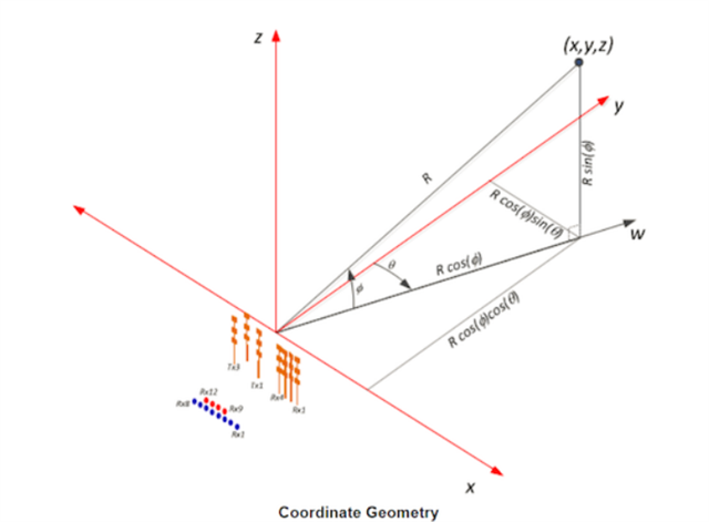

  • Hi Jackson,
    1. The Z axis is the value which had been computed by range and sine of elevation as followings,
        based on SENSOR view with celling mounted  (not WORLD view here)
      Based on IWR6843 3D(r, az, el) -> (x, y, z)
    r : range
    el: elevation φ az: azimuth θ z = r * sin(φ) x = r * cos(φ) * sin(θ) y = r * cos(φ) * cos(θ)
