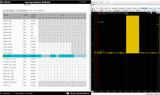

I have a question regarding the state of shield driver on the FDC1004. When the sensor is not active and converting is the shield driver output grounded or is at a high impedance?

    While waiting for your response, I did a test on my own with the FDC1004EVM. Below is the screen shot of what I see.
    The registers of the FDC1004 are shown. CHA is configured to CIN1, CIN2, CIN3, CIN4 respectively. and all of CHB is configured to be the CAPDAC at with an offset capacitance setting of 0. The waveform on the right is a measurement of the SHLD1 pin on the evaluation module. Repeated measurement is off (bit 8  in FDC_CONF).
    From my observation a  single measurement on CIN1 is taken and SHLD1 is activated only when I write to the FDC_CONF reg with bit 8 = 0 and bit 7 = 1. Otherwise, when I am not writing to that register, I am not seeing any signal on my scope connected to SHLD1.
    The behavior seems to be a different then what you mentioned. Is there an explanation to what I am seeing?

  • Hello Brian,
    My apologies. I understand what you are asking about now. In this case, the shield does have an internal GND connection for when the device is not measuring the channels.

  • Hi Justin,
    Just to confirm,  is there an internal GND connection when the device is not measuring the channels? When I was probing the shield output, I'm not sure if it is grounded. The signal seems to be low but it seems to be a high impedance signal.

  • Hello Brian,
    Based on bench analysis, the Shield1 pin acts more like a weak pull down when not in use. If the pin is shorted to a voltage, the pin can start to have some strange behavior. It doesn't stay pulled down but won't go to the voltage of the short.
