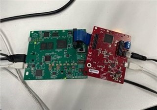

after power up, FTDI and Ethernet port can't be recognized by PC even all the driver installed correctly.

What is the mmWave sensor you're using in this context? Can you also send a picture of your device manager window and your hardware setup?

Hello Ishita,
The board is power up fine with LEDs glow.
It's not our first time we use DCA1000. Another DAC1000 can capture data normally, but this one just can't be connect to PC even with same PC.
Also, temperature of this DCA1000 is externally high after power up.
May I ask you to change another DCA1000 board for us?

Can you also send a picture of the board for me to have a visual inspection (the picture you attached above is a bit blur)
Also, what is the specification of the power supply used by you in case of the defected board? Are you supplying power through an individual adapter or is it taking from the AWR mmWave board?

we try individual adapter and taking from AWR board both, it just doesn't work.
Hello Wang,
What is the specification of the power supply used by you in case of the defected board? Did you use a higher voltage (>5V) supply here?
If you take only the DCA1000 board and just powerup it up with a 5V supply, how much current is it consuming? It typically takes <0.7A.

Hello
we use DC power supply V = 5v/2A, taking from AWR EVB.
Again with same DC power supply and same PC environment, one DCA1000 works well, another doesn't work.
Hello Wang,
How much current is the DCA1000 consuming when you power up the board?
