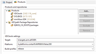

  • Thanks . It's strange because, if I just create a barebones SYS/BIOS project, I get the same results. I have attached the MSS/DSS projects for reference, they are small, and just the initial projects.
    In terms of steps, I created these by doing the following:
    1.) Create a new CCS project, Selecting SYS/BIOS 'Typical' as the Template, and setting the target to AWR6843
    2.) In the 'Products' tab, the Target, and Platform fields are empty. The Platform field has an indicator for a drop-down, but it's empty. To manually fill these fields in, I grabbed the two fields from the out-of-box demo, and changes IWR to AWR.
    3.) Perform the same steps for the C67XX project. In this case, the 'Target' field was already filled in, so I only had to update the Platform field. That too had an empty drop-down, so I manually filled in based on the out-of-box demo.
    At this point, the projects get created, but when building, both fail with the same error:
    The AWR68XX device is not currently supported.
    The following devices are supported in the ti.catalog.arm.cortexr5 catalog:
    	AM65X  RM57D8XX  SIMFLEMING  SIMMAXWELL
    subdir_rules.mk:12: recipe for target 'build-1178647759-inproc' failed
    js: "C:/ti/bios_6_73_01_01/packages/ti/sysbios/family/arm/Settings.xs", line 744: Error: Unsupported device!
        "C:/ti/bios_6_73_01_01/packages/ti/sysbios/family/arm/Settings.xs", line 912
        "C:/ti/bios_6_73_01_01/packages/ti/sysbios/family/Settings.xs", line 254
        "C:/ti/bios_6_73_01_01/packages/ti/sysbios/family/Settings.xs", line 124
        "C:/Users/user/workspace_v11/Bert_MSS_Delete/app.cfg", line 12
        "./package/cfg/app_per4ft.cfg", line 204
    gmake.exe: *** [package.mak:202: package/cfg/app_per4ft.xdl] Error 1
    js: "C:/ti/ccs1100/xdctools_3_62_01_16_core/packages/xdc/tools/Cmdr.xs", line 52: Error: xdc.tools.configuro: configuration failed due to earlier errors (status = 2); 'linker.cmd' deleted.
    gmake[1]: *** [build-1178647759-inproc] Error 1
    gmake: *** No rule to make target 'build-1178647759', needed by 'configPkg/compiler.opt'.
    gmake: *** No rule to make target 'build-1178647759', needed by 'configPkg/linker.cmd'.
    gmake: Target 'all' not remade because of errors.
    Let me know if anything jumps out.
    Thanks!

    Having the project set to IWR instead of AWR in CCS should not have any effect on the project performance. IWR6843 and AWR6843 are made from the same silicon, but since IWR was created first, the AWR equivalent was not always called out as supported. I will look into whether we can correct this inconsistency on our end, but could you try running your project with it set as IWR for the time being? Please let me know if you run into any issues.
