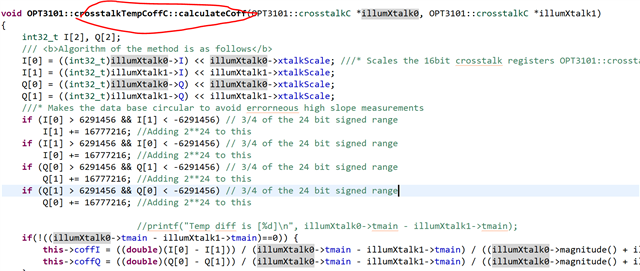

  • Hi Alex
    Thanks for your reply.  Got it. Another question for coefficient calculate.
    How to use the test data to calculate the ''CrosstalkTempCoff''  ''PhaseTempCoff''  ''PhaseAmbientCoff''?
    I have test the temperature  crosstalk, the data is in the txt file, the result is all the coffI and coffQ equal 0.00. The result is correct?  I am confused about this!  The ''CrosstalkTempCoff'' need manually calculate? I see the firmware can calculate this but the function''calibrationSession_perDesignCalibrationCrosstalkTemp()'' doesn't use the below function.

  • Hi Joe,
    The line fit to the data has to be performed externally to determine the coefficient. See Figure 3. Illumination crosstalk coefficient determination in https://www.ti.com/lit/ug/slau791/slau791.pdf?ts=1636587921013

  • Hi Alex,
    Thanks and hope you all is well.
    For calibration, I have two question for the coefficient calculation:
    (1) CrosstalkTempCoff calculation:
    You told me see the  figure3 , but the coefficient is not suitable for SDK. What is the method of the below picture, the "b=42.47", I am afraid that is not correct, I see the SDK, the coffI and coffQ are between 0~1. So this method is just coffI=(phase1-phase2)/(temp1-temp2) ?
    The method in the above picture is different from the below picture about the CrosstalkTempCoff calculation
    So which method should I calculate, I am so confused about this!
    (2)  PhaseAmbientCoff calculation
    How can I calculate for PhaseAmbientCoff? For this picture I can't see it use the "PWL", how should I choose the "splitsReg"? This method is also different from the SDK.
    So could tell the detailed method of these coefficient calculation? Why the pdf file and SDK are totally different for the calculation? The method of SDK has any function, I see these coefficient calculation has never used by the main.cpp

  • Hi Joe,
    1) Please check the linked "how to calibrate document" as it addresses this question. Please see section 3.5: "The SDK uses simple 2 point data slope estimation methods for all the coefficients. This is just a example estimation for simplicity. In real life a more elaborate estimation is recommended using tools capable of plotting and straight line fitting. In the case of temperature coefficient estimation a simple linear fit is what is required, whereas in the case of the ambient coefficient a more complex 4 segment piece-wise-linear fit needs to be used. In the later sections some example plots and best line fits are shown."
    I also want to make sure, you will not copy the line fit from the document as this is example data, correct? Data will vary be design so customer will need to collect the data and perform the line fit to get the coefficients.
    2) We have a simplified calibration process in the SDK quick start users guide. Have you looked at this? When the SDK zip file is downloaded there is a pdf document included as well as python script for performing this piece wise linear fit (PLW). Depending on customer system and given number of questions, I may suggest to use the MSP430 launchpad calibration tool mode mentioned here as the process for calibration is more streamlined and easy with no code changed needed to the SDK.
