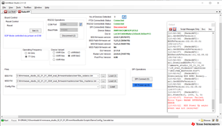

    thought I ought to give you an update ... new pc (now win10) in place and nearly recovered everything. I still have one or two issues, which I haven't managed to solve yet, before I can give you screens shots from the last question:
    mmWaveStudio - installed OK, but doesn't work. Runs, get the "file" etc ribbon, but everything else just a gray screen.

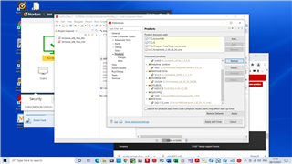

    In CCS go to Window->Preferences->Code Composer Studio->Products. Then install the versions of the software packages are missing when you import the projects. The needed packages are installed with the SDK installation, but sometimes need to be installed in CCS as described above.

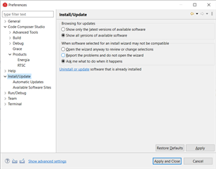

    trying to get ccs exactly as it was, but struggling with having now got newer versions of some tools (bios & xdctools in particular) - project gives errors which look to be caused by using these newer versions.
    On WINDOW > PREFERENCES, I have INSTALL/UPDATE set to show all versions, but PRODUCTS will not let me select them. so I only have the latest available. What am I missing to configure specific versions?

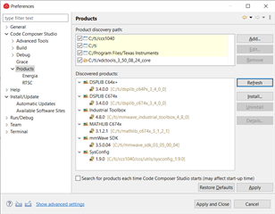

    as  you know I'm also now trying to configure a new PC as the old one died.  I had copied the entire c:/ti directory before the crash, and started out by copying this to the new C: drive.  When I got "not installed" errors, I tried re-downloading some parts, hence why I now seem tp have multiple versions of some.  I was thinking there might be a difference between "copy" and "install" - but now I know about the PREFERNCES page, I think I have the answer to that bit. I didn't have any pf these issues with the original installs on the old PC,  but as I was downloading so much to get started, I can't remember what order I may have done things in.
    CCS: 10.4.0.00006
    SDK: 03_05_00_04
    ITB: 4_8_0
    I also have:
    BIOS: 6_73_01_01 plus 6_83_00_18
    XDCTOOLS: 3_50_08_24_core (in C:/ti) plus 3_62_01_15_core (in C:/ti/ccs1040)
    When I compile DSS, it warns about the BIOS version, but seems happy with the newer one.  With MSS, many errors, and XDC tells me to use the older one which, so far, I haven't managed to configure CCS to do.  I could always just delete the newer ones, but I'd rather learn more about how CCS works.

    Have you tried clicking on "Refresh" this will bring up products that you can install which probably include the version for the OOB e.g. the older versions. I would deselect all of those that appear and select the products that CCS has called out are not the right version. Let me know how that goes. If it doesn't work please send a screen shot of the window that you get after clicking on the "Refresh" button.
    Best regards
    Connor Desmond
  • Hi Connor,

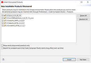

    yes, I've refreshed etc - and all it will show is the latest. Yes, I could just delete all unwanted versions, bit I'd rather get this sorted, as a) I can learn about CCS and b) if this isn't working, then there may be other issues with my installation.  Screen shots: c:/TI directory so ypu can see exactly my set-uo; UPDATES page and then REFRESH page .. if it works.
    and the products page:
    I've uninstalled BIOS & XDC just to make it show them in REFRESH.  If I hadn't, they wouldn't list at all, although the other three DO appear on every refresh, even after I've selected & installed them.
    Hope that shows you what you need.

    I would suggest doing a fresh install of CCS, SDK, and Industrial Toolbox. Let me know if that works.
    Connor Desmond
  • Hi Connor,
    now on CCS11 & ITB 4_9, same SDK as before, but a fresh install etc.  I'm mow back to being able to load the ITB OOB demo & compile OK, having made sure I've got the right versions of things selected. I'm so glad I only have to write software for in-house use, so don't need to know if things have been loaded & installed correctly, or what else might be on a user's pC!

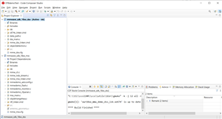

    Staring with the OOB demo code (ITB4_9 now):the project chosen seems definitely to be for 1843, or at least 18XX:
    However, the project seems to be set for 6843 - in the PROPERTIES page:
    This compiles OK - but I need to be absolutely sure of what's going on here...

    I do need mmwaveStudio along the way: check comms work; control the device; collect data with "known good" code to compare with anything I write myself.
    Unfortunately, the link you gave doesn't seem to work.  It opens resource explorer, but gives this message:
    This resource does not exist. Check your URL or select another resource to view.

    thanks for the info - very nearly there now!  mmWaveStudio now runs OK, but I haven't got the SPI working yet (ethernet set up done).  Here's a screen shot:
    Looks like I've got all the interfaces (bar ethernet) and set-up/downloads working ... this all worked before, but now I've also got to contend with win10 being different to work with than win7 where I was before (FTDI etc drivers seem OK though).  Presumably the docs I have already will have the information about how to get past this hurdle - then should be able to capture some data i./e. back where i was and ready to really start work!
    As for FLASHing & CCS usage - the above proves the interfaces are OK, so shouldn't be far off with them either.
    many thanks
    Alan
  • Hi again Brennan,
    its amazing how sending a message makes what you couldn't see become totally obvious!  Its not the ethernet, its that I hadn't connected the second USB yet - trying to do things one step at a time etc.
    Data all the way through to post processing now, so other issues should be soluble too - I'll mark this thread as resolved.
    many thanks for your inputs (can't promise I won't need more),
