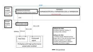

  • Hi Alexander,
    Thanks for your response. From going through the documents and links, my understanding is that the below is what the system block diagram would look like? As regards the wireless connectivity, could recommend either a compatible module that can send the raw data wirelessly to the PC or a module that can be attached to the system where we can do our processing then send our processed data wirelessly?
  • Hi Lillian,
    Yes the overall block diagram looks correct.
    Here are a few suggestions regarding the transfer of raw adc data.
    1. I am not sure on the space requirements or how permanent of a solution you need but you could have your system (EVM + DCA1000EVM) connected to a remote computer which can then send information to a secondary computer or cloud storage which can simplify the design.
    2. Another option is if you are only looking for a subsect of the adc raw data, I was talking with another engineer on my team and he has created an image that can transmit raw ADC over uart at a slower speed. In this case you would not need the DCA1000EVM and could connect the radar EVM to a Wifi Launchpad EVM for wireless transmission to a computer. If you want a large amount of data at a high chirp/frame rate or all of the data then you will still need the DCA1000EVM which currently we have not looked into wirelessly transmitting that much data through a WiFi Launchpad EVM.
