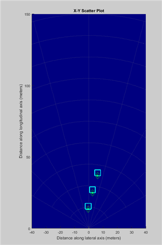

Now I am running the traffic monitoring Lab config, which can achieve the detection of 75 meters. My detection object is the vehicle.
Could anybody help me to extend the range to around 150 meters in Lab traffic monitoring interface?

    We have tested robust detection with AWR1843BOOST up to 120m. There is detection possible at 150m but with AWR1843BOOST it will not be robust. You would need a different high gain antenna.
    In order to achieve longest range detection you would need to use the full L3 memory for the radar cube.
    In order to test 150m:
    1) Need to create a chirp configuration for this range
    Please refer to the following configuration.
    mmwave_automotive_toolbox_3_3_0__win\mmwave_automotive_toolbox_3_#_#\labs\lab0007_medium_range_radar\src\common\mrr_config_chirp_design_MRR120.h
    2) Need to make sure that the traffic monitoring demo can support this chirp configuration.
    You would need to test it yourself
    Unfortunately the team that developed the traffic monitoring demo is no longer available for support

    2. I used the pre-build binary now and change the GUI (maximum depth) to 150 meters that were originally 80 meters. But I am not sure if I need to further modify the config file to achieve this range.

    Your observation is correct. The lab/medium-range radar does not support replay the recorded data. matlab scripts that implemented this feature initially for development are provided but not validated.
    In the "lab/medium-range radar" it is not possible to remove the static objects. You could modify the demo to add this feature.
