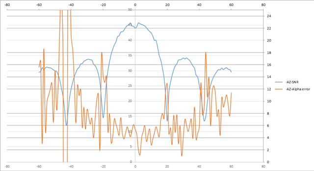

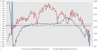

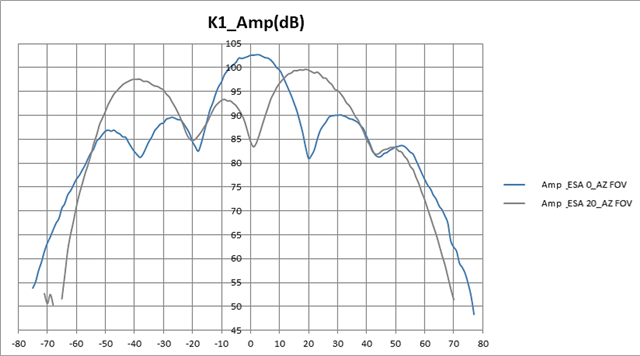

     We had the measurement as below pictures.
     In first picture, the blue color line was set at 3 TX simultaneously transmitting with all 0 degree. The grey color line is to shift the TX phase for +20 degree result. The y-axis is the SNR reading.
     The below 2nd picture shows with the angle accuracy (error) measurement in orange color line. The y-axis in right side is the degree of angle error. As you can see that the error can vary from 2 degree to 8 degree within +/- 20 FoV.

    Actually I have some more question on your testing
    1)Did you perform these measurements by capturing raw data with DCA1000 board? Or did you use another method?
    2) When "The grey color line is to shift the TX phase for +20 degree result." what was the value programmed to the phase shifters
    3) In the 2nd Picture, what is the value programmed to phase shifters? Based on the blue line it seems that Tx Phase =0. Is this correct?

  • Hi Cesar,
     Please see answers:
     1). Customer uses her own GUI to read back the SNR and angle data. The test is in chamber room with a 3cm size corner reflector set in boresight of AWR1843 device in 2.85m.
     2). The grey color line was just for testing to shift the angle by 20 degree modification from profileCfg. Please discard this first, since we didn't have its angle accuracy measurement. Because we found the angle error is larger when 3 TX are enabled together that we want to fix first.
     3). The three TX are enabled with 0 degree TxPhase as attached cfg file "R151-ESA_0 deg.cfg".

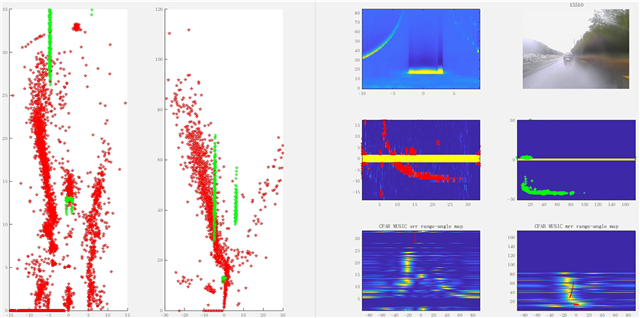

    I am also having this problem when I tried to test the AoA performance of AWR1843. Below is my test result using a corner reflector at an empty open field.
    Also, when I test a moving target which travelling a circle in front of our radar from right side to left side. It showed a discontinuous track as below. The left side picture full of red points was the object's track. It should be like a round circle, bu turn out to be a pattern like this. Some part of it, the track jumped from one angle straightly to another(like the right up part of this track). And the left part of this track the main lobe energy was totally leak to the side lobe which caused the second track route(which should not be exist).
    And, when I test the 'radar angle alignment 'using a road side guard rail, the result is showed below. I was trying to match the lidar point cloud and the radar point cloud when detect the road side guard rails. Like the picture shows below, the left side of it is also the guard rail points both from the radar(red points) and the lidar(green points).
    If the angle estimation performance was good, the red points(radar output) from both side of the road guard rail should at least be parallel. But the result showed a fairly big offset. The far left pic was from usrr mode, and the one next to it was from mrr. The result shows out that the offset was even larger at mrr mode.
    I am pretty sure this was caused by the angle estimation error now when I saw you guys' issue, So how can I fix this using some inherent method like radar calibration or some other method?

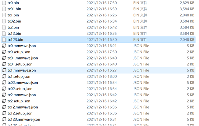

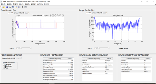

    I have done the experiment under a 5GHZ chamber like below with a single corner reflector in front of our radar equipment 5 meters away. The freq band does not match well but the chamber still provide a clean environment.
    The data can be analysised by the code  under:
    C:\ti\mmwave_studio_02_01_01_00\mmWaveStudio\MatlabExamples\singlechip_raw_data_reader_example.
    The data has two format, one is '.bin', one is '.json'. The 'bin' files are the data and the 'json' files are the parameters. What you should do is:
    0. the files are like below:
    'tx0' means using 0 tx and 4 rx
    'tx01' means using 01 yx and 4 rx
    1. put the 'bin' files into 'C:\ti\mmwave_studio_02_01_01_00\mmWaveStudio\PostProc\'
    2. put the 'json' files into 'C:\ti\mmwave_studio_02_01_01_00\mmWaveStudio\JSONSampleFiles\18xx\'
    3. open matlab and direct to 'C:\ti\mmwave_studio_02_01_01_00\mmWaveStudio\MatlabExamples\singlechip_raw_data_reader_example\'. You will see three files: 1.'rawDataReader.m', 2.'verify_data.m', 3.'readme.txt'.
    4. use this command to call the data read function:
    rawDataReader('C:\ti\mmwave_studio_02_01_01_00\mmWaveStudio\JSONSampleFiles\18xx\tx0.setup.json', 'C:\ti\mmwave_studio_02_01_01_00\mmWaveStudio\PostProc\tx0.bin', 'tx0.mat', 1);
    and the results are like:
    then u can compute the phase or anything you like.
    singleTXlikeTestData.rar
  • Thank you
    We will review the data
    Cesar
    any update?
    Sorry for the delayed reply.
    I suspect some capture issue in the setup. The time domain data is expected to be a sine wave. Instead, we see mostly zeros in time domain with some random glitches. Range profile (Frequency domain) should show a strong peak due to the corner reflector. However, we see mostly noise.
    Can you please cross check the data capture to see if something is wrong?

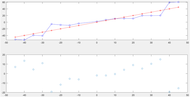

  • Cesar,
    Recently, we verify the same case as using 6843. The degree of angle error is as the following
    This result show the case of 6843 will not vary so much vs. 1843.
