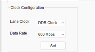

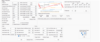

I am capturing the ADC data using AWR 1843 + DCA 1000
After the connections and all the setup done
the steps I am following for saving the data are shown in below figure 1 to 3
the after step 3. in the below folder
ti\mmwave_studio_02_01_01_00\mmWaveStudio\PostProc
the adc_data.bin is the required ADC  file
My question is can I save the ADC data without doing step 3 that Is post-processing. Because this post-processing is not working for a few of the chirp configurations, maybe due to some memory problem?
I have my script for post-processing. I don't want the MM wave post-processing; I need only ADC data.
