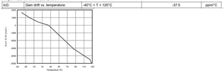

There is an issue related temperature. The measured capacitance increases as device temp increases. Is it related gain drift and offset drift? Or Is the other factor related temp? Please review it and below question and let me know your opinion.
1. Gain Drift
  • We can see below data from datasheet. But I don’t understand the meaning of PPM unit. The -37.5ppm/C seems to mean that the gain is decreased by the slope of 37.5. For example, the gain drift at room temp(25C) is 0ppm, but 5000ppm at -125C. Is it mean the gain at -125C is reduced by 0.5%(5000PPM) than gain at room temp(25C). is it right? Please let me know your opinion.
2. Gain
  • Gain equation is Gain = GAIN_CAL[15:0]/2^14
  • [15:14] 2MSB is integer portion of the Gain. 00 mean gain is 0.xx, 01 mean gain is 1.xx, 10 mean gain is 2.xx, 11 mean gain is 3.xx. Is it right?

    1. The typical spec for the gain drift of -37.5 ppm/C is reflective of the overall trend across the device operating temperature range.  For instance, we see about -5000 ppm variation over the range from -23 C to 110 C.  The plot you have cited gives more detail regarding the typical behavior and shows that the slope may deviate slightly from this -37.5 typical performance.  The trend is only characterized and published for the operating range of the device.  The datasheet for FDC1004 specifies an operating range from -40 to +125 C.  What should be observed is that for temperatures below 25C, there will be an increase in gain due to a positive gain drift, while for temperatures above 25C there will be a negative gain shift due to negative gain drift.
    The minimum storage temperature for this device is -65C.  The device behavior is unknown and not guaranteed at -125C.

    My question is 125C not -125C. Is it mean the gain at 125C is reduced by 0.5%(5000PPM) than gain at room temp(25C).
    For clarity, -5000 ppm variation over the range from -23 C to 110 C you mentioned mean -0.5% variation. Is it right?

    Yes, your understanding is correct.  -5000 ppm = -0.005000 = -0.5%.  The plot shows that the 0 ppm change occurs at room temperature.  At 125C we expect -0.5% shift in gain from room temp.  At 110C we expect a -0.5% shift from -23C.
