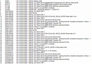

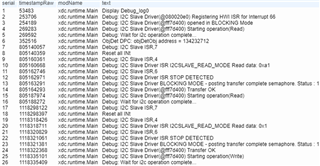

The test program perform a master read first then do a read & write operation.
There are no issue for the first master read operation.
Log as below.
It wait forever after the slave write operation.
In my test program, I do a slave read operation first, then loop below read & write operation.
retVal = I2CSlave_read(i2cHandle, &rxData, 1);
if (retVal == false)
    System_printf("Error: I2C Slave read failed.    \n");
else
    System_printf("Read the data successfully \n");
retVal = I2CSlave_write(i2cHandle, &txData, 1);
  System_printf("Error: I2C Slave write failed. \n");
else
  System_printf("Send out the data successfully\n");
It can work if in the master side add ~0.4s between the master read and write operation.
Logs.
However, this is not a good solution as 0.4s delay is too long.
So, any ideas of what is the root cause?
