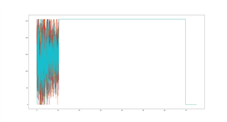

  • This is how my output data looks like.
    I am taking output data after LPF i.e. 0x01.

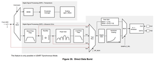

  • Hi Yash,
    Thank you for the waveform. I have discussed the issue with other Engineers, however this is not an issue we have encountered before. Would you be able to change the MUX to output the data directly from the ADC instead of after the LPF. This will help us understand where the 0xFF result is coming from.

  • Hi Jacob,
    Sorry for late reply.
    I changed the MUX output to ADC as you told me. But it doesn't change anything for me. Please let me know if you find anything.
