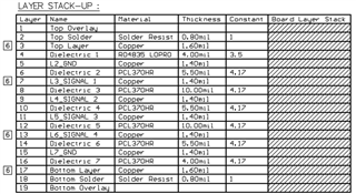

Hi Ti team ,
We are planning to design a new board at our company using the evaluation board as a reference.(IWR6843ISK)
I plan to use the antenna pattern of the evaluation board for the wireless part of the AWR6843.
We are thinking of changing to other materials when we manufacture substrates in Japan because RO4835 and PCL370HR are not available.
However, since the antenna part is for 60GHz signals, I am worried that the slight difference in dielectric constant and dielectric loss tangent may affect the radio characteristics.
Therefore, we are considering alternatives for the substrate material.
(We are planning to copy the layout of the evaluation board for the antenna pattern of the 60GHz RF part.)
If I change the board material in Alternatives 1, 2, and 3 in the table, will it work without problems?
Please let us know if you have any advice on design or evaluation of possible problems with wireless characteristics.
Or, if you have any information about the problems you encountered when you changed the board material while referring to the evaluation board, please let me know.
IWR6843ISK(TI) My alternative proposal 1 My alternative proposal 2 My alternative proposal 3
Number of layers 8 layers IVH(2+6) 8 layers IVH(2+6) 8 layers IVH(2+6) 8 layers IVH(2+6)
Material (L1-L2) RO4835_LOPRO
(ROGERS)
MEGTRON7
(Panasonic)
MEGTRON7
(Panasonic)
MEGTRON7
(Panasonic)
Material (L3-L8) PCL37OHR
(isola)
MEGTRON7
(Panasonic)
R-1566
(Panasonic)
R-1755S
(Panasonic)
Thickness 1.6mm 1.6mm 1.6mm 1.6mm
Surface treatment Silver or Tin Electroless Ni+Au flash Electroless Ni+Au flash Electroless Ni+Au flash
impedance control 50Ω, 100Ω 50Ω, 100Ω 50Ω, 100Ω 50Ω, 100Ω
The board specifications of the IWR6843ISK evaluation board are based on the following documents. "swrc355c.zip PROC073D_FabNotes.PDF"
For the specifications of the boards, I referred to the materials on the websites of the manufacturers.
RO4835(ROGERS)
https://rogerscorp.com/advanced-electronics-solutions/ro4000-series-laminates/ro4835-laminates
PCL370HR(isola)
https://www.isola-group.com/pcb-laminates-prepreg/370hr-laminate-prepreg/
MEGTRON7(Panasonic)
https://industrial.panasonic.com/ww/products/pt/megtron
R-1566(Panasonic)
https://industrial.panasonic.com/ww/products/pt/halogen-free/hfreer1566
R-1755S(Panasonic) *The R-1755S is a link in Japanese because I could only find it for Japan.
https://industrial.panasonic.com/content/data/EM/PDF/cbmcatalog_1906_r1755s.pdf
            Your concern is very right, Layer 1 to 2 material dictates the antenna and transmission line property, If you change the material then DF/DK i.e. Dielectric constant and dissipation factors would get changed, Hence antenna / transmission line need to be re-designed with the newer material. If the new material DK/DF at the operating frequency are the same as that of existing RO4835_LOPRO material then you could consider changing the material.
    On the surface treatment Electroless Ni+Au flash is not recommended for the mmWave frequency due to higher loss, immersion silver pcb finish or OSP treatment is recommended.
    Other than then RF layer (Layer 1-2), You could use other materials.
    If you are facing problem in getting the RO4835_LOPRO material into Japan FABs then we could connect with the Rogers representative to secure the material for your development.
