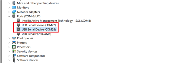

I have a AWR1843Boost. When I connect to it with PC through USB, in device manager I can see two VCPs: XDS110 Class Application/User UART and XDS110 Class Auxiliary Data Port.

Recently, I bought a XDS110 Debug Probe (Part NO: TMDSEMU110-U). When I connect it to PC, in device manager, it looks different from the AWR1843Boost.
Do I need to install XDS110 driver again?? Can you please send me a link of the driver?

    The external XDS110 debug will not show the same COM port names as the debugger on the AWR1843BOOST since they are not the same. But you continue using the debugger , JTAG should work as usual , just like on the AWR1843BOOST.
