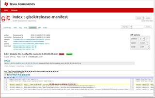

I ran the setup.sh script from to get the source code development using repo tool and I got the following error:
Parsing through much of the help I ran across a thread that mentioned where to get manifest.xml, I noticed there was no file called manifest.xml and I chose the one that looked closest what I needed, and was in line with what the thread was talking about (dra7xx-psdkla_evm_06_00_00_03.xml).
Once I downloaded the release-manifest-master.tar.gz and copied dra7xx-psdkla_evm_06_00_00_03.xml (renamed it to manifest.xml) and placed it into the .repo directory I got the following error:
I tried just a repo sync and got the following error:
So I am wondering if I need to use my TI registered username/password for the repo to work, I am wondering if that is the reason I am getting a connection refused?

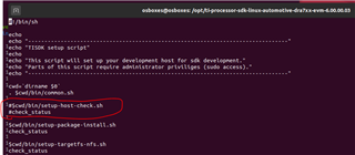

  • I believe I found the solution, I had to go to a later Ubuntu Version (20.04 for me), however this required me to modify the setup.sh and comment out  the lines:
    $cwd/bin/setup-host-check.sh
    check_status

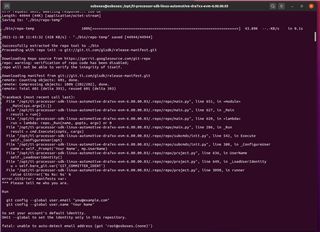

    Then I had to configure git to use my user.email I registered with TI:
    This allowed me to download the source SDK files

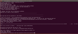

    Proceeding with repo init -u git://git.ti.com/glsdk/release-manifest.git
    repo: error: Python 2 is no longer supported; Please upgrade to Python 3.5+.
    Failed setup, aborting..
  • Hi William,
    I believe the issue is caused by the latest repo tool, the error you are seeing is being thrown by the repo tool. Python 2.7 has been marked EOL sometime in 2020, and the latest repo tool is updated for this.
    Can you give the output of repo --version?
