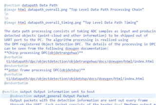

In the mmWave Industrial Toolbox Traffic Monitoring demo (and I suppose other demos too) there is a lot of documentation in the code. It contains hyperlinks, links to images, references to other sections etc.
I want to know how one can go about "rendering" this documentation. Right now it all just gets displayed in plaintext. I also couldn't find it anywhere in the Industrial Toolbox files. I installed Eclox, but figured out that it has nothing to do with Doxygen.
I'm guessing it probably gets displayed similar to other topics under the F1 help menu, but I can't seem to figure out how to make the menu find this topic.

    Is there some specific info you are looking for? Most of this is from the SDK files and does get rendered in the SDK Doxygen. Please see the SDK documentation with the below file.
    "C:\ti\mmwave_sdk_03_05_00_04\docs\mmwave_sdk_module_documentation.html"
