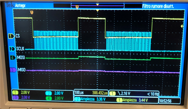

I am trying to configure SPI between MCU and 2 components.
MCU: CC2538
Component1: TDC1000
Component2: TDC7200
I am not able to make any read or write instuction
I have attached a plot of my signlas, while trying to read a register
My MCU is operating with 32MHZ external oscilator
Both the TDC components have a clock of 8MHz
I am not able to debug the problem
Configuring MISO and MOSI as GPIO; I am able to toggle them. But with SPI, they don't move
Thank you

    The TDC1000 and the TDC7200 use a similar operation for SPI communication.
    8MHz is suitable for the clk frequency.
    Below is an example read command issued to the TDC7200. This command represents a register read at address 10h, with a 24 bit response on the MISO line.
    From your scope-shot, it looks like the amplitude of the MOSI line is relatively low compared to what I would expect. Are you using 3.3V logic to drive the MOSI pin?
    Finally, try to issue a register read command similar to my waveform on the TDC7200 register 01h. This register should have a default value of 40h upon reading the register.
    Please let me know if you have any questions,
