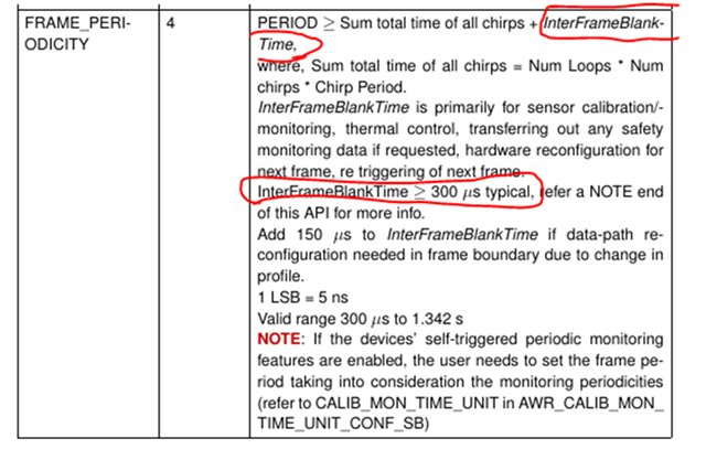

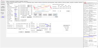

Dear Engineer,
I use IWR1443BOOST+DCA1000EVM+ MMWave Studio2.1.1.0 to capture the original data. The configuration of frame and CHIRp is shown in the figure below.
However, there is a problem after trigger Frame. Output gives a large number of repeated prompts and errors, as shown in the figure below.
After getting these suspicious hints, I thought there might be something wrong with the data collected in this operation, so I prepared to take it again. I did not do other operations. I directly modified the frame quantity in the sensor Config interface and then clicked "Set", but output got a red Error "Status: Failed, Error Type: RESP TIMEOUT". As shown in the figure below.
Then I found that all configurations displayed the same Error "Status: Failed, Error Type: RESP TIMEOUT" as soon as I clicked the "Set" button, unless I restarted all configurations from the "Connection" interface.
What do these outputs mean? Why is that? How to solve it?

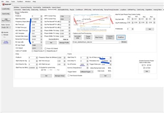

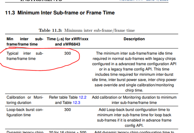

  • I followed the instructions in 'mmwave-radar-interface-Control (10)' as shown below, idle time+ramp time=50us, frame Periodicity =0.25ms.
    I then tried multiple frame Periodicity values and found no error when the frame Periodicity was greater than or equal to 0.3ms. Why is that?
  • Unfortunately, when I increased the number of frames further, No of frames=50000 and frame Periodicity was still 0.3ms. Also started reporting errors.

    [15:30:06]  MSS RF Error status Async event recieved(0x1)
    [15:30:06]  BSS CPU Fault error status Async event recieved(0x3)
    [15:30:06]  Reserved(0x0)
    [15:30:06]  LineNum(0x2FC)
    [15:30:06]  FaultLR(0x26EC8)
    [15:30:06]  FaultPrevLR(0x0)
    [15:30:06]  FaultSPSR(0x19F)
    [15:30:06]  FaultSP(0x800FBB0)
    [15:30:06]  FaultCauseAddress(0x0)
    [15:30:07]  FaultErrorStatus(0xFFFF)
    [15:30:07]  FaultErrorSourced(0xFF)
    [15:30:07]  FaultAXIErrorType(0xFF)
    [15:30:07]  FaultAccessType(0xFF)
    [15:30:07]  FaultRecoveryType(0xFF)
    [15:30:07]  Reserved2(0x0)
    [15:30:07]  BSS ESM Group1 Fault error status Async event recieved(0x0)
    [15:30:07]  BSS ESM Group2 Fault error status Async event recieved(0x0)
    [15:30:07]  Analog fault Async event recieved(0x0)
    [15:30:07]  Reserved(0x0)
    [15:30:07]  FaultSig(0x0)
    [15:30:07]  Reserved3(0x0)

    [15:30:54]  Status: Failed, Error Type: RESP TIMEOUT
    [15:30:54]  [RadarAPI]: ar1.FrameConfig(0, 0, 40000, 1, 0.25, 0, 0, 1)
    [15:30:58]  Status: Failed, Error Type: RESP TIMEOUT
    [15:30:58]  [RadarAPI]: MatlabProc Status: Failed

    I consulted with the relevant team member on this. The fault that is occurring is the BSS TX buffer full. The warning async events indicate that there is not enough time in the inter-frame period to perform some background tasks.
    The frame periodicity being used is too small in your configuration (0.25ms). As per the mmWave ICD, you should add the minimum inter-frame blanking time to the total chirp time to arrive at the frame period. For the configuration of 43uS chirp time, you should provide more than 350uS frame time to allow sufficient time for the internal calibrations like APLL/synth and other software overheads (see 11.3 below).
    Can you try increasing the frame-periodicity to the recommended level and see if it solves your issue?
    Ishita

  • Hello Kelong,
    This is taken from the mmWave Interface Control document (mmWave ICD). Here is the link : mmWave-Radar-Interface-Control.pdf
    Ishita
