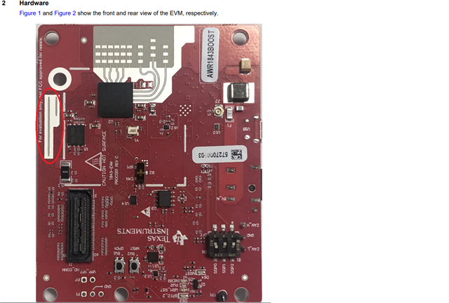

Hello Champs,
What's the unit function of below red high lighted?
Thanks.
Rgds
Shine

That is a coupon structure for measuring the etching tolerance of the antenna structures for evaluating the manufacturer capabilities.
You can read some more about it in the below app note or if you search 'coupon' on this forum you can find some additional threads about it.
https://www.ti.com/lit/an/spracg5/spracg5.pdf
