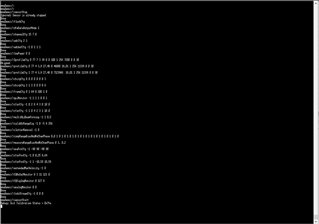

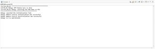

  • Hi Aayush,
    Thanks for the reply,  I have executed this is CCS debug mode.  I am not getting any errors and also the sensorStart is not happening.
    I have attached the console message ,the teraTerm output screenshots and the cfg file. Please check and let me know.
