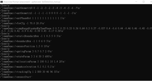

Dear TI,
We do calibration for our device (using our own antenna) from OOB demo, and we get result as follow
compRangeBiasAndRxChanPhase 0 0.7 0.35 0.53 0.56 0.64 0.5 0.57 -0.057 0.4 -0.6 0.44 -0.46 0.46 -0.48 -0.07 -0.5 -0.62 0.42 -0.9 0.42 -0.59 0.45 -0.17 0.58
but when we input this value to 3d people counting demo cfg, the demo simply do not run (it's already achieve sensorStart stage, but freeze on that step), while it is running smoothly when we use default config (compRangeBiasAndRxChanPhase 0 1 0 1 0... 1 0). Do you have any idea why it happened, and what will be the solution? Thank You very much.
