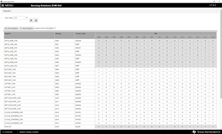

Dear, LSB register of DATA is alway 0*FFFF for every channel:
Could you tel me how ti solve this issue.
Thank you
Best regards
PORTE Florian
    I have a couple questions for you to help debug this:
    • Can you share the values of your ERROR_CONFIG and CONFIG registers?
    • Can you take an oscilloscope capture of the sensor waveform to make sure the sensor is oscillating properly?
    Thank you,
    Justin Beigel
