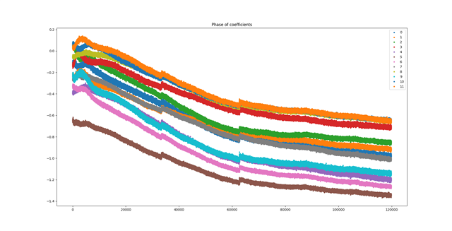

I am using the demo from sdk_03_05_00_04 to generate the calibration coefficients with the following CLI command :
measureRangeBiasAndRxChanPhase
I also use the special profile_calibration.cfg file for that.
I am using a small corner reflector as a target at ~2m.
When I plot the evolution of the coefficients phase at room temperature (~10°C) during ~12 hours, I obtain a slow drift of absolute phases :
The relative phases are relatively constant.
When I do the same with a 60°->20°C temperature sweep (nonlinear sweep : only passive cooling), there are transitions where the relative phases change a lot (let's say the brown curve is ahead of the blue one and after the transition it is the opposite) :
I understand the radar performs continuously self-calibration as described in SPRACF4B, which would explain the transitions.
You can see that the phase correction coefficients will depend a lot on the temperature selected.
Are the coefficients valid only for the same temperature with the following CLI command compRangeBiasAndRxChanPhase ?
Or do we need to perform this operation only at room temperature, and the chip will compensate at different temperatures ?

    You only need to perform this operation once. Just to give a brief background on this, the Rx gain or TX power (or any other RF/Analog aspect) may vary from device to device due to manufacturing process variations and also across temperature. Hence, the purpose of calibration is to ensure the RX gain and output power are maintained as configured by the user despite variations in process and temperature.
    To achieve this, the internal processor adjusts the mmWave circuit configurations at initialization (to mitigate effects of process variation) and periodically at runtime (to mitigate effects of temperature drifts).

    - The calibration coefficients are measured once. They compensate for the variability of the manufacturing process of the chip and PCB traces.
    - These coefficients seem to be heavily dependent on the temperature at which the calibration is performed.
    - These coefficients are sent to the radar at every startup through CLI. If the radar starts at a temperature different from the one the calibration was made, I do not understand how this could compensate properly as these coefficients are sent without any information about the temperature at which they have been measured.

    The CLI command compRangeBiasAndRxChanPhase takes into account the temperature at the time of calibration, and sets the baseline for future measurements.  The automatic RF calibration procedure will adjust for temperature changes in future measurements.
