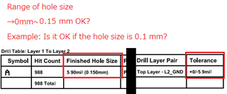

I have a question about the VIA specification in the board manufacturing data for the evaluation board (IWR6843ISK).
Is it correct to assume that the hole size ranges from 0mm to 0.15mm according to the following VIA specifications?
For example, is it possible to manufacture with a hole size of 0.1mm?
For the board manufacturing data, I referred to the following document.
SWRC355C.ZIP
www.tij.co.jp/.../swrc355
File storage location
\swrc355\xWR6843ISK_DesignFiles\Rev_D\Fabrication Drawing\PROC073D_FabNotes.PDF
The notation for the figure is on the second page of the PDF file.
Thank you for your kind attention to the above.
Tsutomu Watanabe.

  • Hello Tsutomu,
    The via sizes for the antenna section should not be changed if you are planning to copy our antenna design.
    The other vias can be any size you want. You would need to work directly with your board manufacturer to understand their capabilities and tolerances, we cannot answer that question for you. If you do change the via size, you will need to make sure you can still meet the current requirements for all of the high current paths on the PCB.
    Adrian

    Also, please tell me how to read the table of antenna section via size.
    The design value of the via size is 0.15mm and the tolerance is written as +0mm and -0.15mm.
    In that case, should the via size be in the range of 0 mm to 0.15 mm including the manufacturing finish tolerance?

  • Hello Tsutomu,
    You are right, the hole tolerance is strange. A 0mil drill would not make sense. Let me check internally and see why the tolerance is specified that way.
    Adrian
