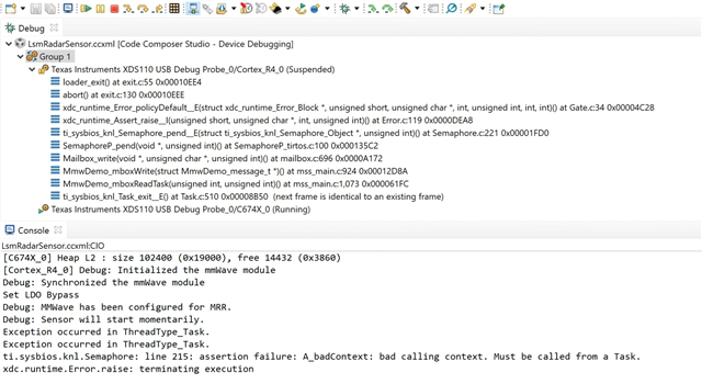

Our project is base on automotive lab demo mrr. We added a new task into the mss_main.c, the task is used to read Uart data and send message to CAN bus at runtime.

The program does running well sometimes, but most time, it will terminate due to a runtime error after few minutes running.
Can you please check if this problem is caused by the new task I created?
    I can think of two causes:
    1. Can you confirm that semaphore pend is being called from task context only and not in any interrupt context? Semaphore pends cannot be called in interrupt contexts. This is what the error log seems to indicate.
    2. It is unlikely, but perhaps  it could be a stack overflow issue. Could you ensure that the stack size allocated to the new task is enough? If there are any large arrays being allocated on the stack by this task as local variables, this would be something to consider. Perhaps for debugging you can consider making them global.

    No need for this. I asked because of the error prompt in your screenshot. It seemed to indicate that the issue originated because semaphore pend was being called in an interrupt context. But it seems that you have not added any semaphore pend calls, so this should not be the root cause.
